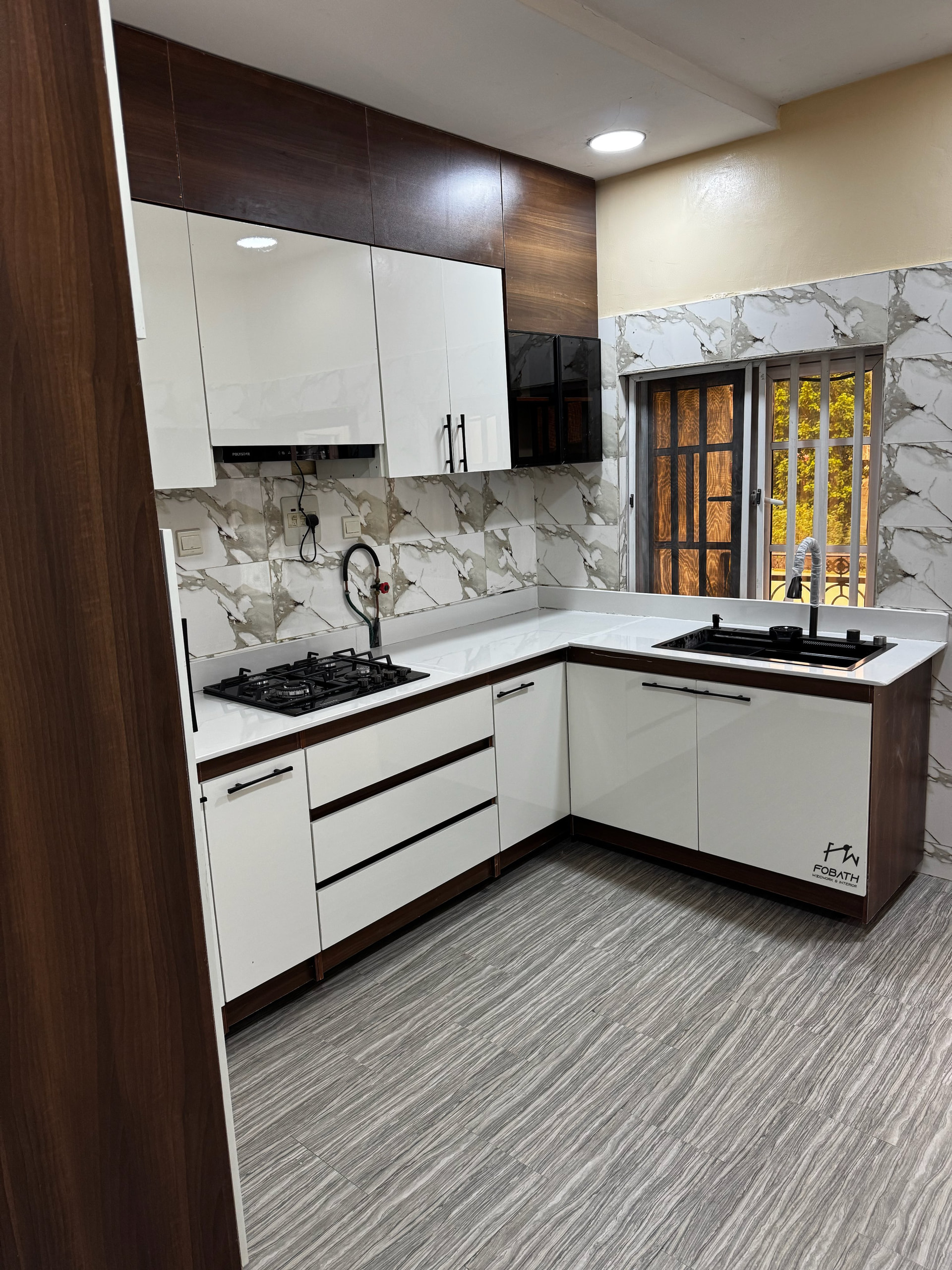

Wow so beautiful and professional
Keep on the good work buddy
This is a very helpful renovation insight
Thanks for sharing this update
You are on point brother.
Well detailed, nice work
What a nice job buddy
