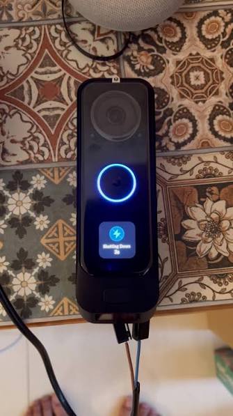

I got tired of missing package deliveries because our old mechanical chime is barely audible from the backyard, so I finally ordered one of those new smart video doorbells with the motion camera. The retail box claimed it uses the existing low-voltage wiring and mounts directly over the old button in under ten minutes. Instead, dealing with ancient house wires and a narrow door frame turned into a giant test of patience.
The main trouble started the second I unscrewed the old plastic ringer casing from the front door trim. The previous builder had left absolutely zero slack in the low voltage wires, and the second the copper plate broke loose, the hot wire snapped right at the base and slipped back inside the wall cavity. I spent forty minutes hunched over on the porch steps with a flashlight and a pair of long needle nose pliers, aggressively trying to fish the tiny wire back out through a narrow hole without ripping the insulation.
Then came the real breakdown with the transformer voltage requirements. When I finally hooked up the terminals and flipped the house breaker back on, the new smart camera just sat there flashing a slow red error light because our old chime transformer downstairs wasn’t pushing enough power to run the digital lens. I had to drop everything, run down to the dark basement utility closet, and swap the old transformer module for a higher output version just to get the system to boot up.
The video camera is securely screwed into the front door trim now and the digital lens links up to the home WiFi network perfectly. The motion detection alerts hit my phone instantly whenever a package gets dropped on the steps, and the video stream is completely clear without any lagging or signal drops. The front porch security setup functions fine now.
