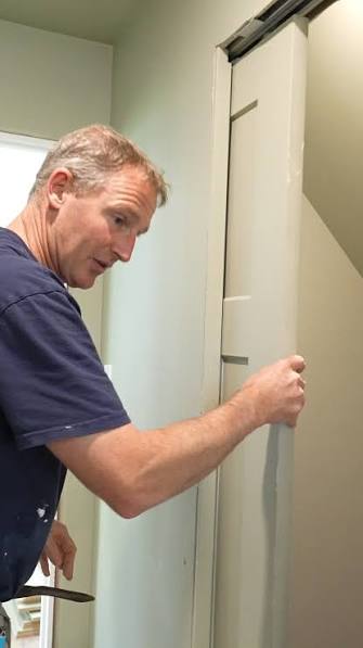

The sliding wooden pocket door in the main hallway has been sticking halfway inside the wall cavity for a month, and this morning it completely jammed solid and refused to budge at all. I thought Iโ€™d just get a flat pry bar, gently wiggle the bottom track, and pop the roller wheels back into the overhead groove in five minutes flat. What an absolute nightmare. Trying to fix a door that is physically trapped inside a hidden drywall slot is a giant exercise in pure frustration.
The absolute worst part was trying to see what was actually blocking the track inside the dark wall gap. I had to lay flat on the hallway floor with a tiny flashlight, trying to peer into a two-inch opening while getting a face full of old construction dust every time I moved. The bottom guide clip had completely twisted sideways, meaning the wood frame was wedged tight against the internal metal studs. Trying to reach a screwdriver into that narrow slot to loosen the guide bracket was a total geometric nightmare.
When I finally forced the door to slide out of the wall, the top plastic roller wheel completely snapped right off its aluminum hanger track. I had to spend forty minutes carefully fishing the broken plastic pieces out of the deep overhead rail using a magnet and a piece of wire coat hanger. Then, trying to screw the replacement wheel assembly onto the top edge of the door while balancing the heavy wooden panel on the tips of my boots took way too many tries.
The door finally slides back and forth inside the wall slot now without getting stuck or making that loud scratching noise against the drywall. The top rollers track smoothly along the overhead rail and the privacy latch aligns with the strike plate properly when you close it all the way. The pocket door operates completely normally now.
