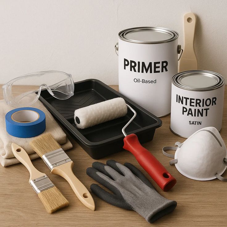

Painting is probably my favorite DIY renovation project because it’s one of the few things that can totally change how a room feels without costing a fortune or taking forever. I’ve done it in my own house multiple times, and every single time I’m amazed at how fresh and new everything looks afterward.
If you’re just starting out, walls, ceilings, and trim are all very doable. Even painting kitchen cabinets is realistic if you prep properly. The real secret isn’t in the painting itself — it’s in the preparation. Trust me, rushing the prep is where most people go wrong. Take the time to wash the walls, fill every little hole and crack, caulk the gaps along the baseboards, and give everything a light sand. It makes a huge difference in the final result.
Here’s what I’ve learned from experience:
Buy decent brushes and rollers. The cheap ones from the dollar store will frustrate you and leave a messy finish.
Always use primer, especially on dark walls or new drywall.
Cut in the corners and edges first with a good angled brush, then roll in a “W” or “M” pattern so you don’t get ugly stripes.
Two coats are almost always necessary. Lightly sand between coats with fine sandpaper for that smooth, professional touch.
Go with eggshell or satin in kitchens and bathrooms because they’re easier to wipe clean. Matte looks beautiful in living rooms and bedrooms.
Open the windows, use a fan, and take your time. Pull off the painter’s tape while the paint is still a bit tacky for sharper lines. And don’t forget drop cloths — paint drips have a way of finding your floor no matter how careful you are.
You can easily paint an average-sized bedroom for under $200 if you shop smart. A lot of people start with just one room, fall in love with the transformation, and then keep going through the whole house. It’s such a satisfying project because the results are quick and you can always repaint if you decide you hate the color later.
