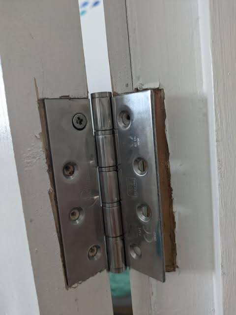

Our heavy aluminum storm door started catching on the bottom threshold, requiring a aggressive upward yank just to get it to latch. I figured the top hinge leaf had just worked its screws loose over the winter. I grabbed a cordless impact driver and a pack of heavy-duty replacement screws, expecting to tighten it up and be back inside before my coffee got cold.
​Instead, I walked right into a structural trap.
​The moment I backed out the original screws, they brought a cascade of rotted, wet wood pulp with them. The exterior door casing had been slowly taking on moisture behind the aluminum trim for years. There was absolutely nothing left inside the jamb for the new screws to bite into; they just spun uselessly in the soft wood like a spoon in oatmeal.
​To fix it properly, a simple tightening job turned into an impromptu framing extraction. I had to unhang the entire heavy glass door, pry off the exterior trim moldings, cut out a two-foot section of the rotted pine framing, and sister in a fresh piece of pressure-treated lumber.
​The door swings flawlessly now and clicks shut with a satisfying snap, but it was a harsh reminder of home ownership reality: behind every minor cosmetic sag, there’s usually a hidden defect just waiting for you to look too closely.
