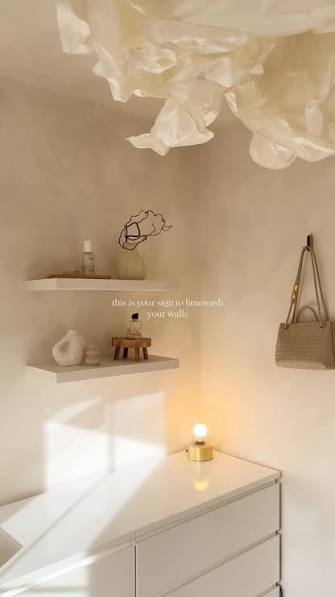

I wanted to replace the flat grey paint in my bedroom with a soft, textured limewash finish. I bought into the online hype: it’s eco-friendly, breathes naturally, and gives you that effortless, chalky Mediterranean villa aesthetic. The tutorial made it look like an artistic afternoon of carefree, criss-cross brushstrokes.
​Instead, I ended up with a blotchy, streaky disaster that looked less like a luxury hotel and more like a poorly hidden moisture problem.
​My first mistake was underestimating the porosity of my standard drywall. Limewash doesn’t behave like regular latex paint; it chemically bonds with the surface. Because I rushed the specialized mineral primer coat, the drywall sucked the moisture right out of the limewash in random patches, causing the pigment to dry unevenly and leave harsh, dark overlap marks wherever my brush stopped.
​Fixing it required letting go of the “carefree” mindset. I had to sand down the rough patches, apply a proper, heavy-duty primer, and work at a frantic pace to keep a “wet edge” across the entire wall so the brushstrokes blended seamlessly.
​The final result is beautifully subtle and catches the morning light perfectly. But it taught me a valuable lesson: old-school, natural materials require old-school technique. If you aren’t willing to study the mechanics of how a finish dries, stick to standard matte paint.
