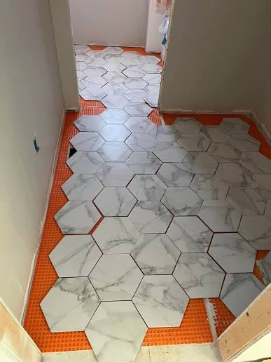

​I wanted a striking, geometric transition between my hardwood hallway and the guest bathroom, so I picked out a gorgeous matte-black hexagon tile. The design plan was seamless: weave the hexagons directly into the wood planks for a high-end, custom look.
​The reality was a brutal lesson in physics and older house construction.
​The moment I cut back the floorboards, I realized the bathroom joists had sagged over the last forty years. While wood planks are forgiving over a slight dip, rigid porcelain tiles absolutely are not. If I laid them down directly, the shifting weight would crack the grout lines within a month.
​I spent two unexpected days hauling heavy cement backer board, mixing self-leveling underlayment to flatten the dip, and meticulously hand-shaving the underside of the wood planks to ensure the two completely different materials met at an exact, trip-free height.
​The blended threshold looks incredible and feels solid underfoot, but it turned a weekend cosmetic upgrade into a grueling structural puzzle. Before you commit to complex tile patterns, ignore the pretty pictures and make sure your subfloor is actually flat enough to handle them.
The hexagons make the flooring steady but the picture don’t look as pretty as one would expect.
Renovations like this should be done by professionals to do it can be done properly
Great lesson: beautiful tile designs depend on solid subfloors, and old house repairs always reveal hidden structural surprises underneath.
