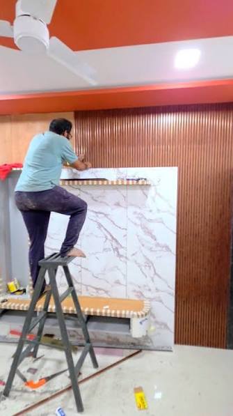

Staring at a tangled mess of black power cords and HDMI cables dangling down a living room wall finally became too much to handle. The plan seemed simple enough, mount a sleek, modern wood slat panel to hide the wires and give the room a premium look. It looked like a straightforward weekend project, but cutting into drywall and dealing with stud placement quickly complicated things.
Finding the structural studs behind the wall is always the first hurdle. Electronic stud finders love to give false readings, especially around electrical boxes. One wrong anchor placement means a heavy, expensive television could end up crashing onto the floor. It took measuring three separate times and using a tiny finishing nail to manually verify the exact center of the wood studs before drilling a single heavy duty lag bolt.
Then came the real headache: cable management. Running power lines directly inside a closed wall cavity without proper in wall rated cables is a massive fire hazard and a total code violation. Fixing this required installing a recessed brush-plate kit to safely route the low voltage cables behind the new panels, out of sight. Getting the interlocking wood slats to line up perfectly straight against an uneven drywall surface required a ton of shimming and patience.
Upgrading an entertainment wall requires looking past the cosmetics. Think about future upgrades before gluing or screwing anything permanently into place. Run an extra empty conduit pipe behind the paneling now, so pulling a new cable through later doesn’t require tearing the whole wall apart. It is a tedious, precise job, but sitting back on the couch with a completely clean, wireless view makes the frustration disappear.
