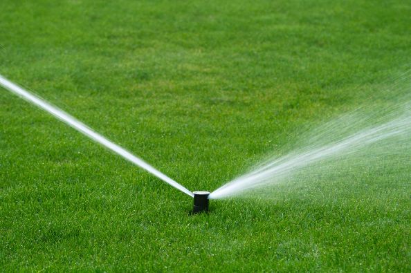

The front lawn grass has been looking completely burnt out and dead from the summer heat, so I finally ordered one of those multi zone automated pop-up sprinkler kits to keep the turf hydrated. The box showed a simple diagram of burying a flexible plastic tube line, attaching the spray heads, and clicking a digital timer onto the outdoor spigot. Instead, trying to dig straight trenches through hard clay and rock turned the entire front yard into a massive construction zone.
The trenching phase before any plumbing could even start was easily the worst part of the project. Our soil is packed solid with thick tree roots from the main oak tree, and my basic shovel kept bouncing right off the dirt without making any depth. I spent three straight hours hunched over on the lawn with a heavy mattock and an axe, aggressively cutting through roots and hauling out heavy rocks just to get a trench deep enough so the lawnmower won’t slice the pipes later.
Then came the real headache of setting the actual pop up spray bodies at the exact right height against the grass line. If the sprinkler head sits even a half inch too high, someone will trip over it, but if it’s too low, the dirt washes right over the nozzle and jams the automatic spring mechanism. I had to manually adjust the threaded riser extensions on six separate heads, packing leveling sand around each plastic base until the spray tops sat perfectly flush with the dirt level.
The water lines are completely buried under the sand now and the digital zone controller is mounted right next to the side hose spigot. The automated timer flips the main valve open right at dawn and the pop up heads lift out of the grass smoothly, throwing a perfect even spray pattern across the entire middle lawn area.
