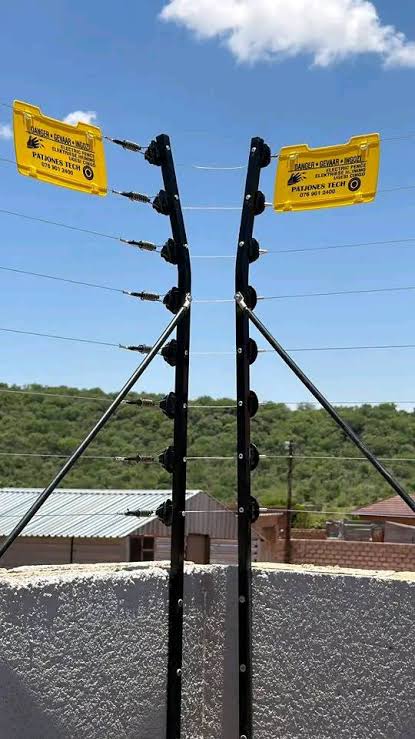

Running an electric security fence line was a total headache
The old wooden boundary wall at the back of the property line is way too low, so I bought a basic multi strand electric fence kit to mount along the top rail to keep stray animals out of the yard. The manual made it look like a breeze where you just screw in some plastic insulators, run the wire, and plug in the charger box. Instead, dealing with wire tension and ground faults turned the whole afternoon into a massive hassle.
The first major annoyance was drilling the mounting brackets into the top of the concrete fence posts. The masonry bit kept hitting hidden rebar inside the concrete, creating a ton of grey dust and dulling the drill tip until it wouldn’t even scratch the surface. I spent an hour balanced on a shaky step stool just trying to get six clean holes drilled so the corner tension bars would actually sit stable without wobbling when the wire pulled tight.
The real breakdown happened during the actual stringing of the high tensile wire strands. If the wire touches a single loose tree branch or a leaf along the entire boundary line, the circuit automatically grounds out and the main alarm box just sits there buzzing an error code at you. I had to spend an hour walking back and forth along the overgrown hedge with garden shears, hacking away tiny twigs and adjusting the plastic tensioners millimeter by millimeter just to stop the wires from sagging into the foliage.
The circuit is fully energized now and the digital display on the controller box shows a clean, constant voltage read across all four lines. The warning signs are clipped onto the front wire grid and the automatic gate cutout switch disengages the power properly whenever the latch opens up. The fence line functions fine now.
