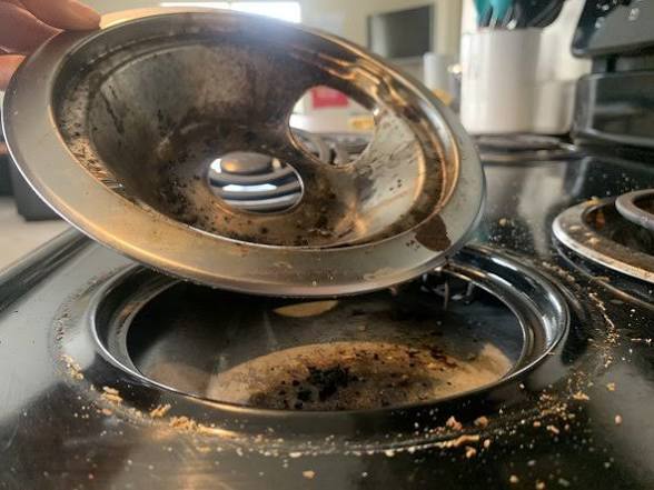

The metal bowls underneath our stove burners have been looking absolutely vile for months because no amount of scrubbing will remove years of burnt grease and boiled over pasta water. They had this permanent black crust baked onto the metal that just smoked and smelled terrible every single time you turned the heat on high. I finally bought a cheap four pack of universal chrome replacement pans at the store today, thinking I’d just lift the coils, swap the bowls, and be done in thirty seconds. What a frustrating little project.
The electric burner coils were completely stuck inside the terminal blocks from all the dried food gunk. When I tried to pull the first element out, the porcelain connection block inside the stove top started creaking and bending like it was about to snap right off the wiring harness. I had to spend fifteen minutes wiggling the heavy metal prongs back and forth with a pair of pliers just to get the crusty burner to release from the socket without tearing the electrical lines apart.
The real breakdown happened when I tried dropping the new chrome pans into the stove cutouts. Even though the retail box said universal fit, the little notch where the burner element slides through was about two millimeters too narrow for my specific stove model. Every time I tried to force the heating coil back into the wall plug, the metal pan would tilt sideways and pop right out of the stove deck hole. I had to take the pans out to the garage, get a metal file, and manually grind down the interior edges of the tin slots until the brackets would finally sit flat.
The burner elements are plugged all the way back into the sockets now and the new chrome pans look bright and clean against the enamel. The coils sit perfectly level so the frying pans don’t slide around when you place them on the burner, and the electrical connection heats up instantly without any weird smoking smells. The burners work fine now.
