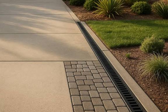

Edge conditions must be addressed. Water often collects at the perimeter of hardscape areas. Without proper edge drainage, erosion undermines restraints and causes spreading. Edge drains or swales redirect runoff safely.
