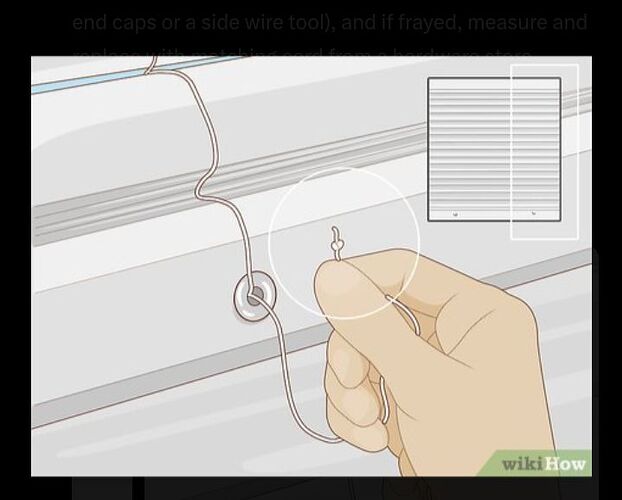

1. Blinds Won’t Go Up or Stay Up (Common in Horizontal or Roller Blinds)
This often stems from a jammed cord lock or frayed cords.
- Check if the cord lock is engaged: Give the cord a firm tug downward, then pull up to release it.
- If that doesn’t work, remove the blind from its brackets by pushing the headrail toward the window and tilting it down.
- Inspect the cords: Untie any knots carefully (access via end caps or a side wire tool), and if frayed, measure and replace with matching cord from a hardware store.
- Reassemble by snapping components back and rehang the blind.
For a visual guide on restringing:

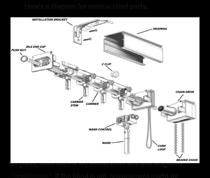

5. Vertical Blinds Specific Issues (e.g., Vanes Not Turning or Falling Off)
- If vanes won’t rotate: Check the carrier stems in the headrail for damage; replace broken ones by snapping out and in new clips.
- For falling vanes: Use repair tabs or clips to reattach to the hooks.
Here’s a diagram for vertical blind parts:
For parts, sites like Fix My Blinds offer kits and diagrams. If the blind is old, replacement might be cheaper than repair—new basic ones start around $20-50. Safety note: In homes with kids or pets, opt for cordless options to prevent strangulation risks.
