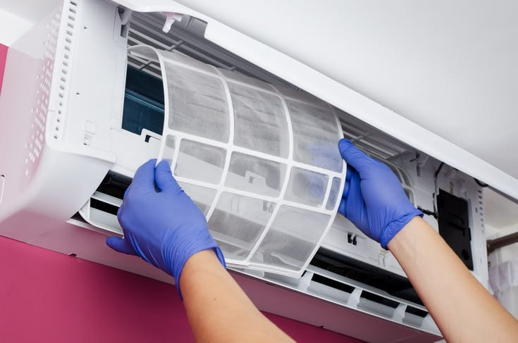

2. Open the Front Cover
Lift the front panel gently and remove the air filters.
3. Wash the Filters
Rinse with lukewarm water
Use mild soap if very dirty
Let them dry completely before reinstalling
Dirty filters reduce cooling and increase electricity bills.

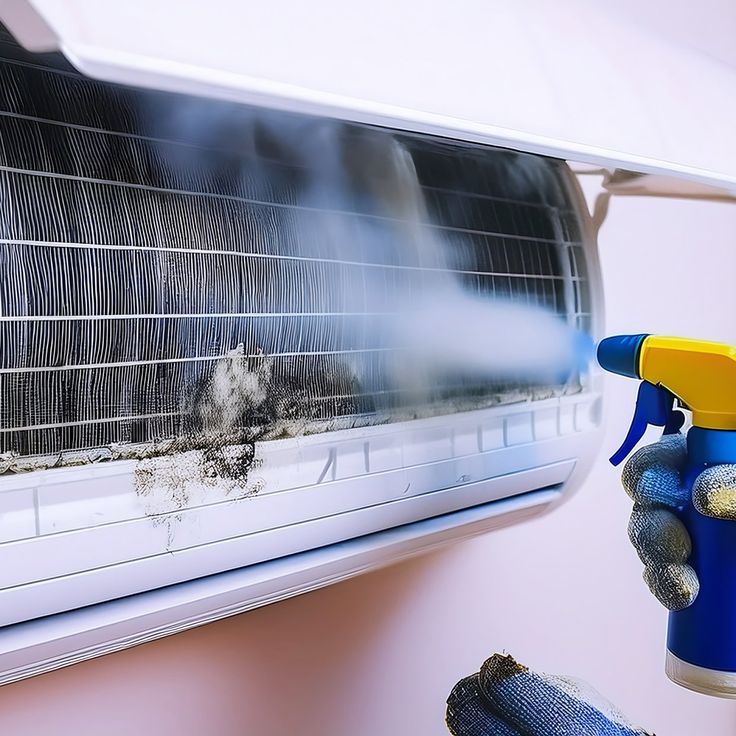

4. Clean the Evaporator Coils
Behind the filters, you’ll see thin metal fins.
Use a soft brush or vacuum gently
Spray coil cleaner or mild soapy water lightly
Don’t bend the fins

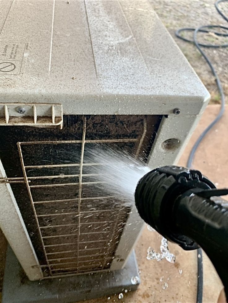

For Outdoor Unit
1. Remove Dirt and Leaves
Clear leaves, dust, and debris around the unit.
2. Clean the Condenser Fins
Use low pressure water
Spray from inside out if possible
Never use high-pressure washers
3. Straighten Bent Fins
Use a fin comb carefully.
