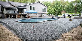

Base material selection affects performance. Crushed stone with angular edges locks together under compaction. Rounded gravel does not interlock and should never be used. Material size should be consistent and appropriate for the project load requirements.

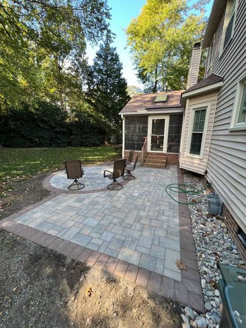

Base installation happens in controlled lifts. Thin layers are compacted individually to achieve maximum density. Dumping all material at once and compacting the surface does not compress lower layers adequately. Layered compaction ensures strength throughout the base. Slope control is built into the base. Drainage must be planned before surface installation. Standing water accelerates failure. A properly sloped base directs water away from structures and prevents erosion beneath hardscape surfaces.
Edge containment begins at the base level. Without restraint, base material spreads outward over time. This leads to edge collapse and surface movement. Edging systems anchor the entire assembly. Final checks ensure flatness and consistency. Straight edges and levels confirm preparation accuracy. Small corrections at this stage prevent major issues later. Base preparation is time consuming and physically demanding, but it determines project longevity. Cutting corners saves hours but costs years of performance.
