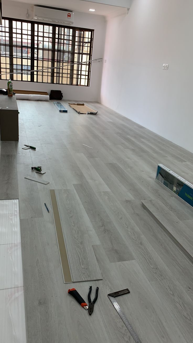

My top recommendation for beginners is luxury vinyl plank (LVP) or click-lock laminate. These floating floors don’t need glue or nails, and they snap together beautifully. They’re also waterproof, which is a lifesaver in kitchens, bathrooms, or entryways where spills happen.

Start in one corner and work across the room, clicking each row into place. Use a tapping block and pull bar for tight fits along the walls.
You’ll need a few tools: a good utility knife, tapping block, pull bar, spacers, and a saw (a jigsaw or miter saw works fine). Measure twice and cut once — especially around doorways and vents.
