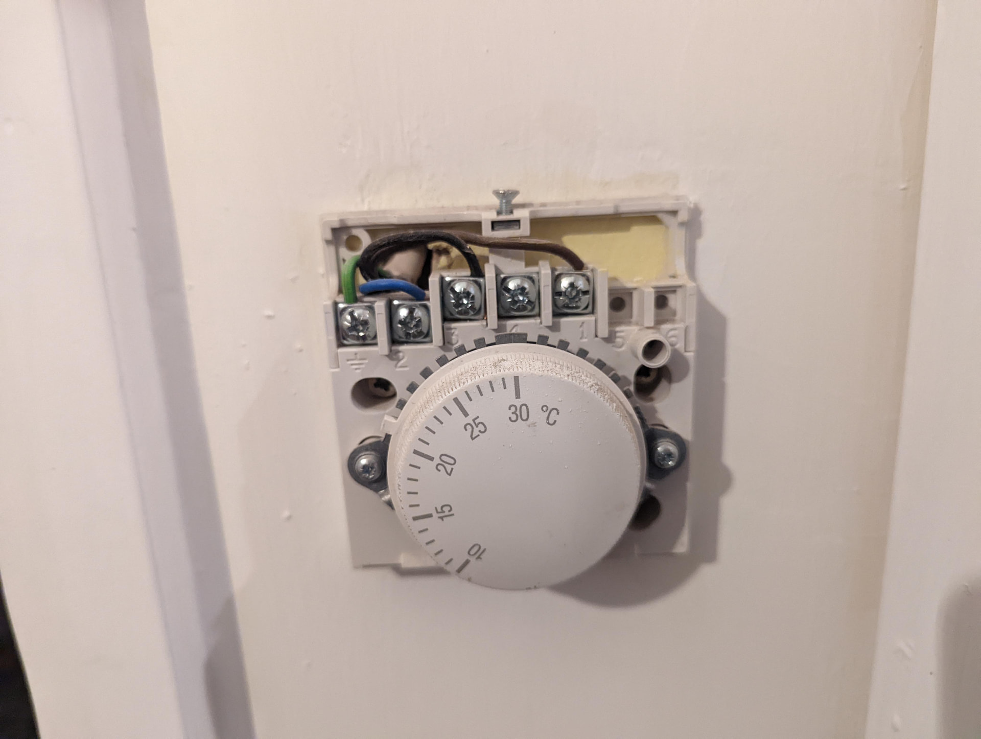

Changing an old thermostat turned into a total wiring guessing game
The ancient dial thermostat in the hallway has been completely misreading the room temperature for months, turning the house into a total sauna before finally shutting off. I bought a basic digital programmable unit from the store, thinking it would be a simple case of matching up five colored wires to the new backplate. Instead, I spent the afternoon hunched over a hole in the drywall trying to figure out why the previous installer used green wires for the heating terminal.
The main headache started the second the old plastic housing came off the wall. None of the wires matched the modern labeling diagrams in the box, and the labels on the copper strands had completely faded over time. I knew if I connected the cooling line to the fan terminal by mistake, I’d end up shorting out the entire control board on my expensive furnace downstairs. I had to spend an hour in the dark hallway with a multimeter, tracing each line back to the basement junction just to figure out which wire actually carried the power.
Mounting the new digital backplate straight was another total hassle because the old screw anchors had completely stripped out the drywall. Every time I tried to tighten the mounting screws, the whole plastic frame would spin and sit crookedly on the wall. I had to pack the holes with fresh plastic anchors and gently tap them in with a hammer before the plate would actually sit level.
The new thermostat is securely screwed to the wall now and the digital screen powers up fine. The furnace kicks on instantly when the temperature drops and the scheduling timer holds the settings without resetting. The climate control is working completely normally now.
