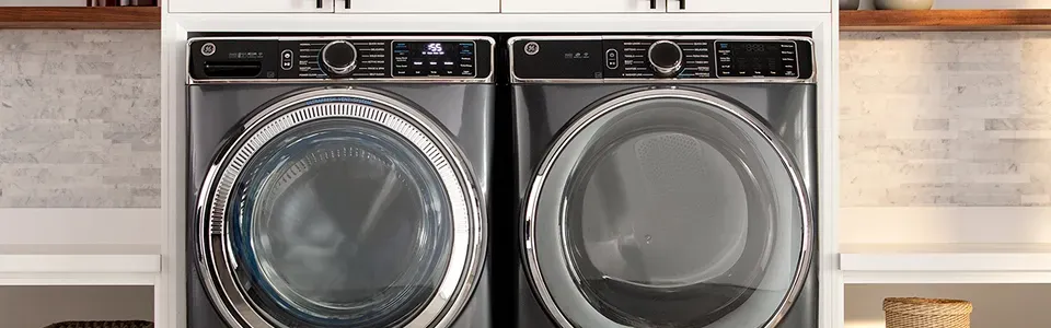

Clothes Dryers: Since dryers use a massive amount of pure heat, the high-efficiency heat-pump models actually save a ton of power around $70 a year compared to standard cheap electric dryers. You break even in less than three years.

Cloth dryers use a lot of pure heat and also a lot of electricity
Your math proves β€œgreen” isn’t a monolith. Heat-pump dryers are absolute no-brainers for quick utility savings, but premium energy-efficient dishwashers rarely justify their upfront cost.
